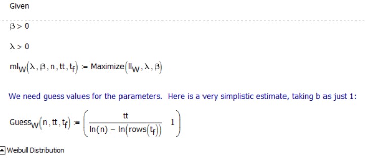

I have tried to convert the attached MC15 worksheet to SMATH. I cannot work around the solve block (Maximize) successfully. I welcome the collabs review and recommendation(s).

#2 Posted: 2018/9/7 14:19:42
Norm Schutzkus
Norm Schutzkus
9 likes in 90 posts.
The solve block is in the "Weibull Distribution" area (collapsed).
