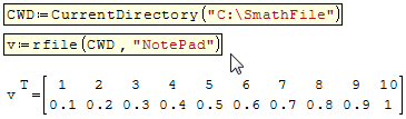

Not clear what you are asking for:
If you C++ application can generate vector of values and if it can write to NotePad,
you can read NotePad from Smath and proceed to the maths you wish, that Smath can digest.
Maybe the other way around ?
