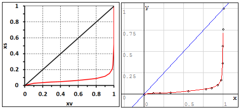

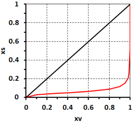

Hi. Looking at the values in the VSD AB Plot.xlsx (42.63 KiB) downloaded 839 time(s).
file, column F is the vapor fractions xv, which vary from 0 to 1 at regular and fixed intervals of 0.1. Which is compatible with the purpose of discretizing the problem by dividing an interval into 100 parts. That is, what you should take as an independent variable is xv and from there calculate the fraction of solid xs, and the partial pressures pA and pB, which would be a procedure independent of the number of subintervals considered, as usual, instead the procedure that you follow in your worksheets, where pA and pB are the independent variables.
WroteThank you for the offer.
But the goal is to calculate the data, not to interpolate them.
Cheers, Pierre
The plot is from discrete calculations, which I don't have.
Discrete calculations are seemingly not from function,
otherwise the plot would be continuous instead of discontinuous.
It is common to reverse Engineer a project for purpose.
Cheers ... Jean.
