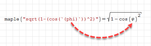

Obviously not, but the bug isn't that obvious: just avoid to use that 'phi' (j Ctrl-G):

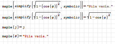

Is it only valid for Windows?
Linux mono doesn't have this problem.
Yes, these are different letters:
cos(ϕ) and cos(φ)
maple() works with φ
This was done to unambiguously convert variables into Greek letters:
maple() function uses implicit encoding of Greek letters:
churichuro 2023/6/9 15:32:00

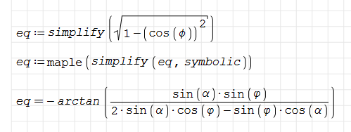

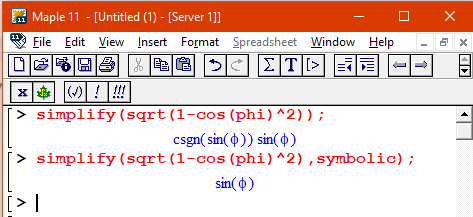

I think the result soomoon expects is this, but it requires a newer version of maple:
where can i get a new version of maple ?
#8 Posted: 2023/6/12 11:12:20
1,123 likes in 1,795 posts.
Inside SMath, you can't. This is a workaround, valid for real values
