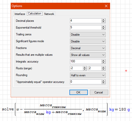

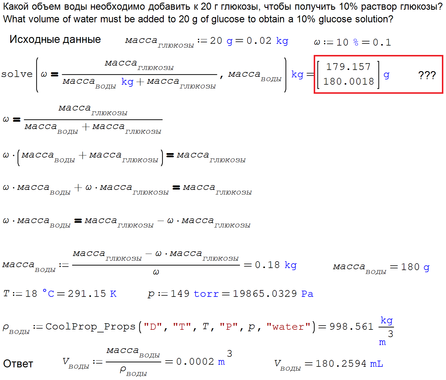

Why two solutions?

#2 Posted: 2023/10/21 02:16:30
1,123 likes in 1,795 posts.
Solve is a numerical procedure. Like all numerical methods, it has the usual issues. Reducing the search interval increases accuracy, returning only one solution. Notice that in the picture the actual interval is from -2000 grams to +2000 grams.

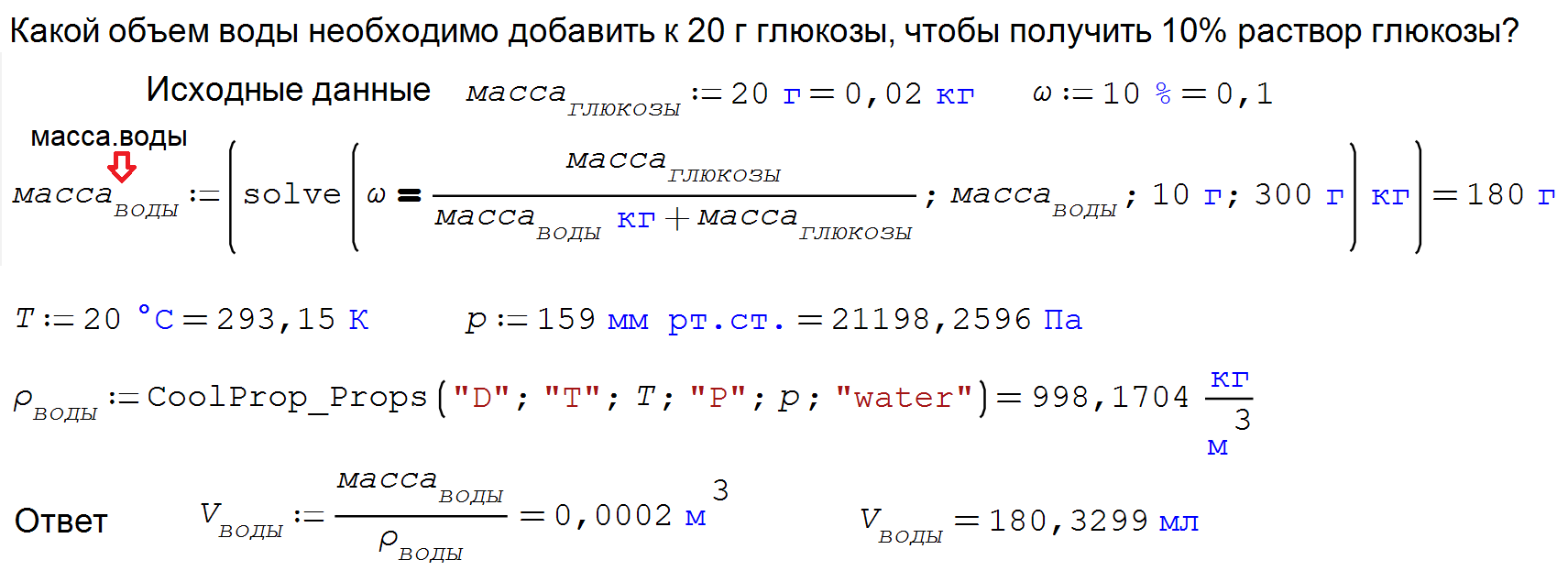

#3 Posted: 2023/10/21 02:25:18
Valery Ochkov
Valery Ochkov
66 likes in 690 posts.
My solution
