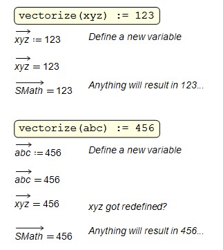

    Finally, I want to inform you of a method that you should not use: Redefining the Special Function 「vectorize()」. Since vectorize is a function, you technically can overwrite it. I will admit, this "looks" like the perfect solution; it is easy to type, looks nice, and is easy to manipulate! However, you will notice two things:
    1. You loose the ability to use the Special Function vectorize() as it is designed for, &
    2. This work-around only redefines the 'arrow,' the text below the arrow is effectively just a place holder (this just leads to needless confusion, as shown below):
    Hope this helps!
