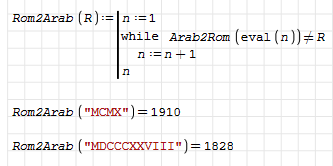

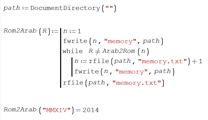

Why doesn't the cycle end?
See please the attachRome-Arab.sm (40.3 KiB) downloaded 876 time(s).

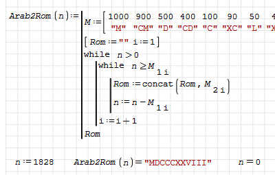

Really it's a very strange bahavior (a bug ?), because the value of variable n is cleared when function returns from Arab2Rom()
So, a solution is to use functions fwrite() and rfile() to save the value of n on a file as a memory:
See the atachment with the solution: Rome-Arab SOLVED.sm (41.21 KiB) downloaded 855 time(s).

Hi. In Arab2Rom(n) you modify n.
That's not good practice. This is a workaround for such cases.

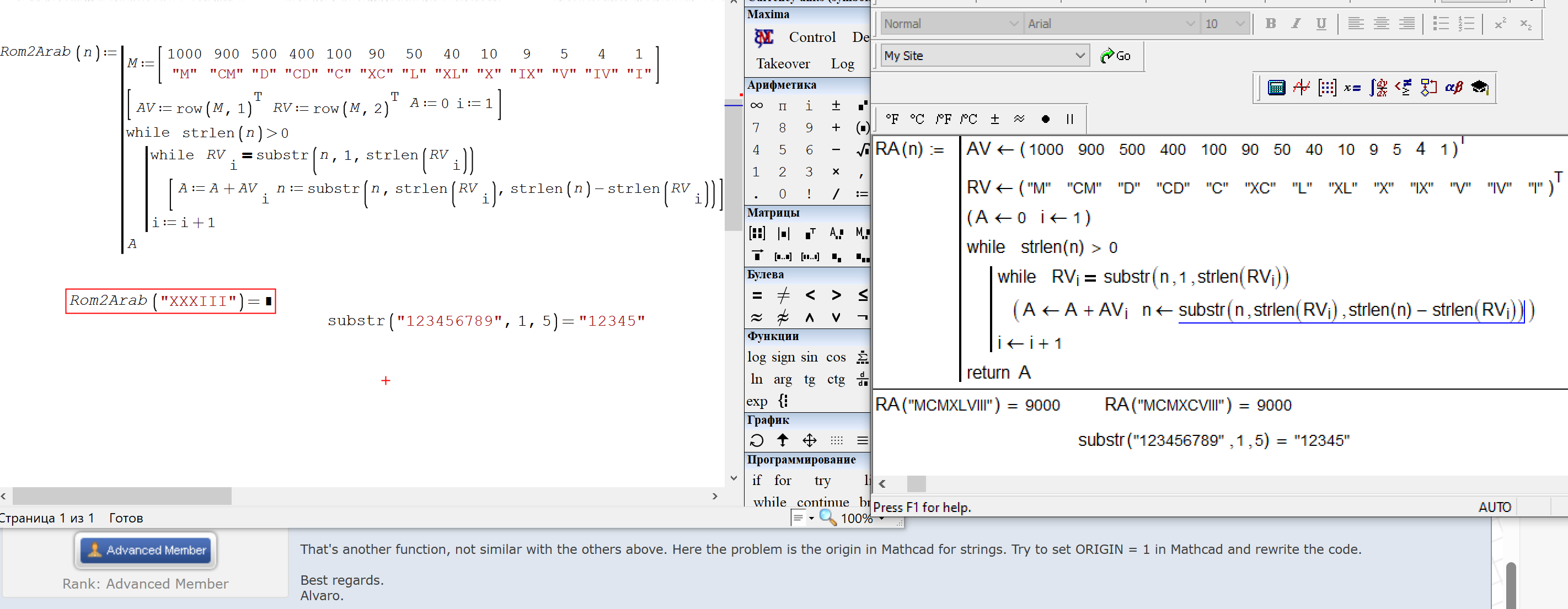

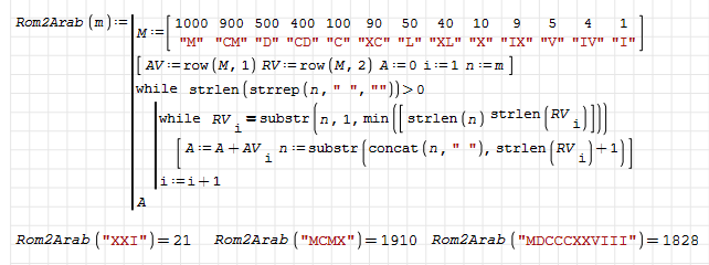

But this have an error too!
Rom2Arab.sm (293.29 KiB) downloaded 856 time(s).

That's another function, not similar with the others above. Here the problem is the origin in Mathcad for strings. Try to set ORIGIN = 1 in Mathcad and rewrite the code.

This is one way.

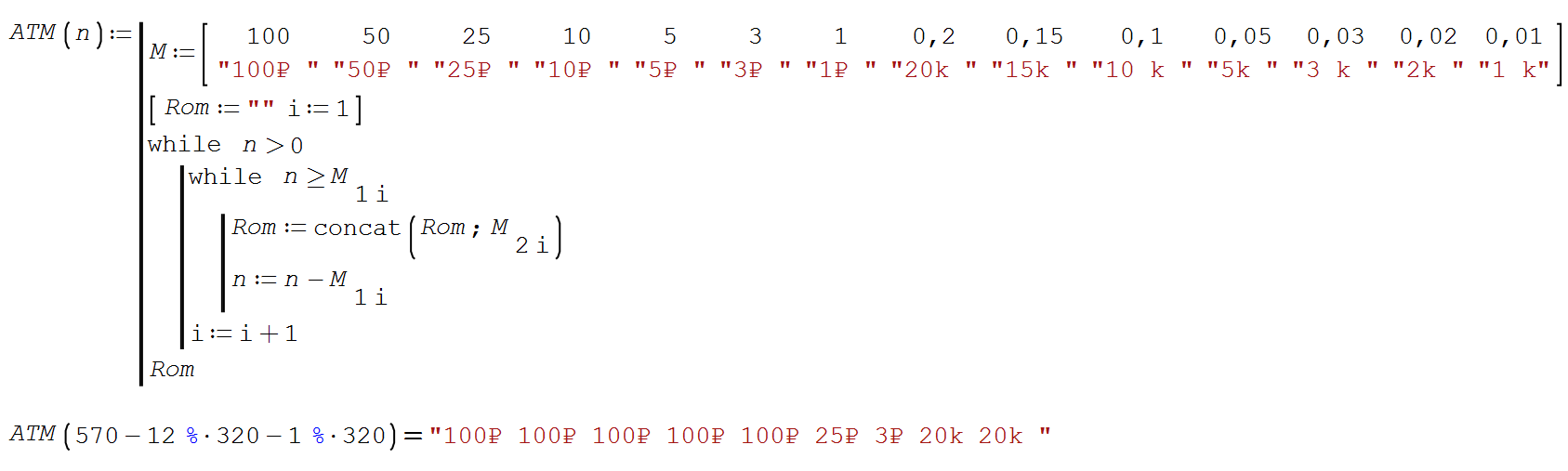

My salary in 1980
ATM-SU.sm (6.29 KiB) downloaded 860 time(s).
