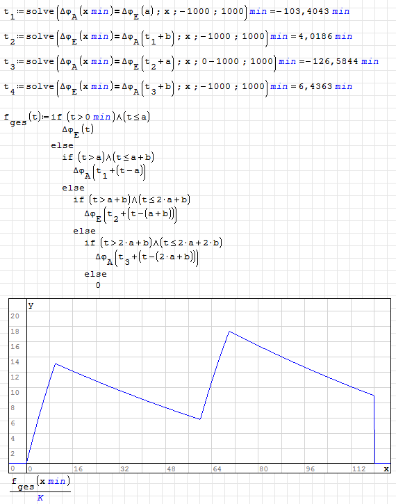

Hello everyone,
I need a little help with the following. I got the heating and cooling curves of an motor (see Picture1)
The Motor will heat up for 10min and then cool down for 50min. This over a specific time period, in the example 2 times. ->120min

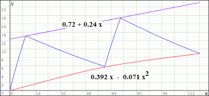

I tried to tie the functions together with the boolean Algebra as a continuous function. It works somehow but I do not get the solution I want to get..The do not connect since the second heating curve starts where the first stopped, not at the cooling curve(Picture 2)

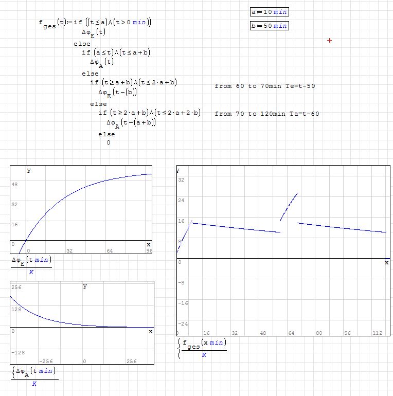

Where I am trying to get to is shown in Picture3 (blue graph).

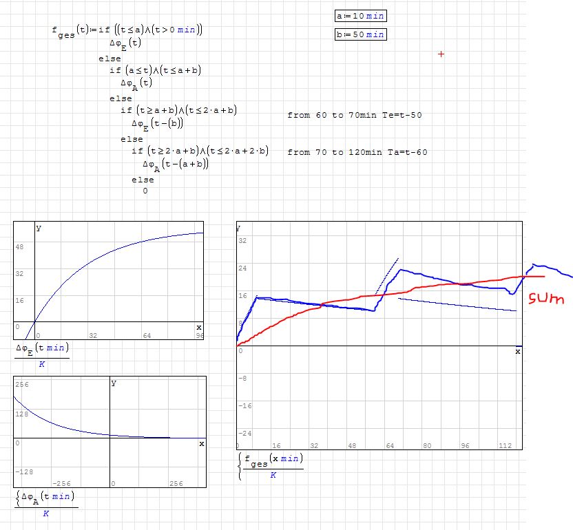

Furthermore I would like to Display a "sum"function in the graph. (Picture3) I have not thought about it yet but I do not think it is this easy with continuous functions. It won't be e.g. h(x)=f(x)*g(x)
Thank you!
Mark

And by the way: cooling is not 15K*e^(-t/165min), but (-15K)*(1-e^(-t/165min)), or 15K*(e^(-t/165min)-1)
Actually, the resulting equation shouldn't operate times, but end temperatures of previous operation, to work as expected. My variant just literally fixes your implementation, but is physically incorrect.
Here's the one that's correct:
С уважением, Михаил Каганский

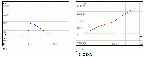

Hello Mike,
1. The function you have collected from "if(s)" .... fges
Discretize in the range of interest.
2. Pass it to the "Finite Differences Integrator"
3. The accuracy of FDI is considered exact.
4. Discretise fine enough, lot of points,
check the changes in the last result.
Attched work sheet should help.
Integrate Discontinuous.sm (25.46 KiB) downloaded 1080 time(s).

Here is your Cumulative Integral. Everything is out
of proportion because it is based on your image, digitised.
The general look will not change from the real project.

#11 Posted: 2016/2/19 12:21:19
Jean: I am struggling with the sum function. Is your "sum-sign" from a plug-in? Because this is not the normal Sum-sign. Can this be done without any plugins?
And is it possible to get not just the red curve but also the upper border curve (green) and lower border curve (grey)? Because this would be my final Goal
________________"Sum-sign"________________
Is your own expresion. The red curve is the "Cumulative Integral"
i.e: the progressive area under the curve, in your case under the
discontinuous zigzag. Easy to draw upper/lower bounds on your plot
1. collect the two XY coordinates of the upper border
add the linterp plot.
2. Collect the 3 points coordinates of the lower border,
There will be 4 alternatives:
a/. Smath built-in "ainterp" spline.
b/. Smath built-in "cinterp" spline
c/. From the 3 points coordinates pass a 2nd order polynomial
This last one is from little program tool utility.
d/. It's possible to pass a Bézier curve as well.
The two borders in the attached are drawn in Paint,
"upper" is a straight line, lower is Bézier Paint tool.
No shame to attach your work sheet... do you fly by yourself
or board on an airplane ? I guess the answer !
Guess the best: once in hand the straigth line function and
the curved function, you will be able to hatch the region
from Martin "hatch utility tool", wouldn't it be nice ?
#12 Posted: 2016/2/19 12:27:27
Sorry, forgot to attach model tool work sheet.
Digitise Model Tutor.sm (35.76 KiB) downloaded 1073 time(s).
