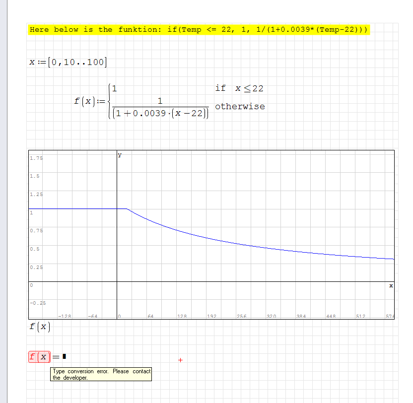

Hello everybody,
I use a beta-Version of SMath and have a question regarding the message:
"Type conversion error. Please contac the developer"
Problem_with_the_function.sm (4.31 KiB) downloaded 937 time(s).

#2 Posted: 2019/3/27 09:08:34
127 likes in 342 posts.
Do you want to get this result?
Problem_with_the_function_ser.sm (4.83 KiB) downloaded 1001 time(s).

Thank you very much, Sergio!
Yes, that's what I wanted to get.

#4 Posted: 2019/3/27 11:16:50
Assign value for evaluation.
Problem_with_the_function.sm (5.08 KiB) downloaded 965 time(s).
