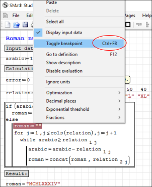

What does this refer to:
"Shortcut key added to Toggle Breakpoint context menu item"
Thanks!
Thanks!
WroteWhat does this refer to:
Sure. Screenshot added above.
Thank you.
