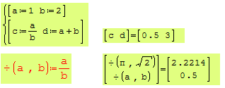

WroteIs there any way to present division on the same line and not as a fraction ?

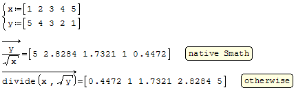

Answer is NO, Smath does not have native ÷ operator
More productive from infix algo style utilities,
for infinite in-situ command line.
infix Divide.sm (3.5 KiB) downloaded 1068 time(s).
Answer is YES, there are multiple ways demonstrated above. Choose what suits you most.
