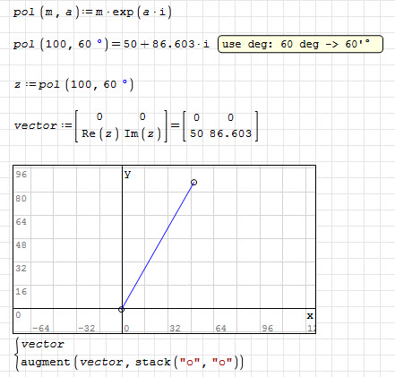

#2 Posted: 2022/5/27 13:57:54
1,554 likes in 1,864 posts.
You can use this method
#3 Posted: 2022/5/27 20:25:23
Joseph Lo
Joseph Lo
0 likes in 4 posts.
Thanks uni for that. I tried it and it seems to work - but is it possible that i don't key in the "degree" sign and still get the same result? i.e. the polar form of 100/_60deg = 50 + j86.6.
If I dont put the degree sign it will return -95.24 -30.48i which is a different result.
Thanks
#4 Posted: 2022/5/28 02:24:39
I tried it and it seems to work - but is it possible that i don't key in the "degree" sign and still get the same result? i.e. the polar form of 100/_60deg = 50 j86.6.

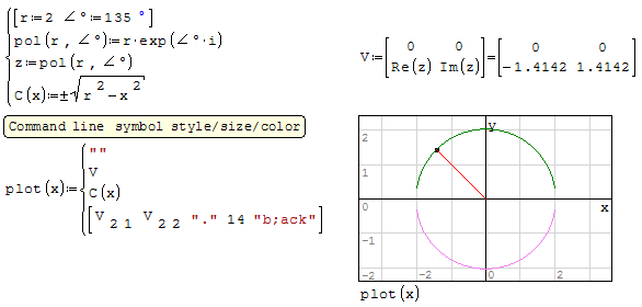

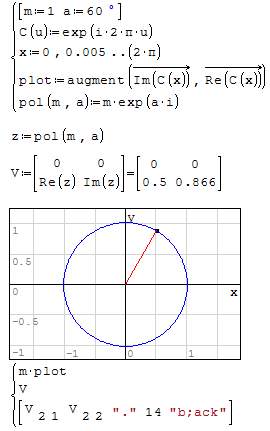

#5 Posted: 2022/5/28 13:24:22
Plot the circle as well.

#8 Posted: 2022/5/29 08:36:55
Interesting thanks for that. I will experiment with that.
You can have it Class Room style.
Cheers from Up There to Down Under ... Jean.
Polar Circle.sm (5.84 KiB) downloaded 1129 time(s).
