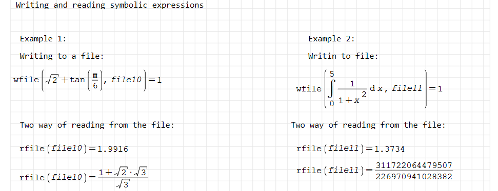

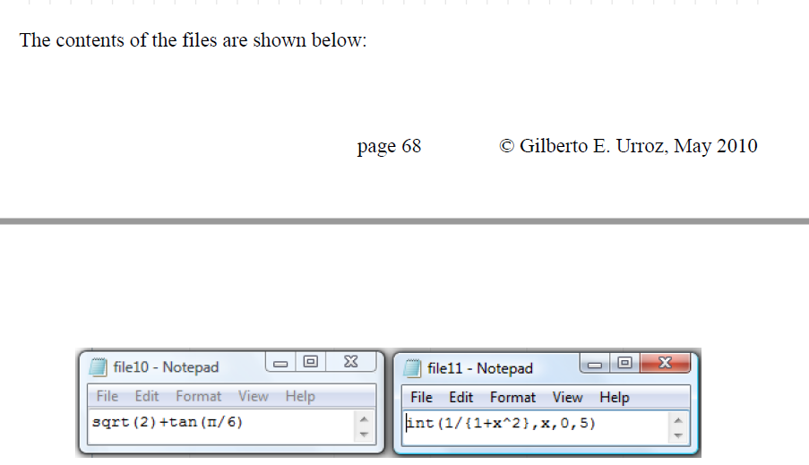

I am studying with Introduction to the use of SMath Studio Prepared by Gilberto E. Urroz, May 2010
p68
i try to that.
The saved file looks like this
why are files different?
#2 Posted: 2023/5/31 05:58:35
1,554 likes in 1,864 posts.
Obviously, there was no preprocessing of the expression in the old version of the program.
