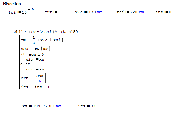

I extracted a part of the entire file. The procedure goal is to evaluate the moment Vs curvature diagram in a reinforced concrete section. The section is discretized in fibers (10x10 in the examples).
In the attached file you will find one iteration (a fixed value of curvature) where the non linear solver have to find the position of neutral axis (x) that lead to the equilibrium of the section (between compression and tension forces).

Here's a transparent, home grown bisection routine that does the job:
RC_forum_nonlinear_b.sm (79.46 KiB) downloaded 1438 time(s).

Many thanks for the quick solution.
I'll include the code in the inner loop of the procedure.

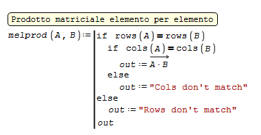

I've implemented the quasi-Newton method (Broyden method - starting from Davide Carpi) to evaluate the best strategy regarding time and number of iterations.

Thank you! With your improvement the speed is significantly increased
