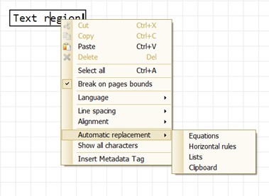

I never saw that behavior. The only SMath option that could be related to the problem, and that I know of, is the one shown in the image.
Perhaps changing some of those options will solve the problem.
Yes I have had problems sometimes with certain programs that interact with the windows clipboard. Even Microsoft Office has options to keep a history of the clipboard, and there are other programs with similar or more advanced features.

Alvaro: what is that "Automatic replacement" option that you showed on the text region context menu? I didn't even know that was there, and when I search for it, I just see it listed as an item in the recent version history, but no explanation of what it does.

Alvaro: what is that "Automatic replacement" option that you showed on the text region context menu? I didn't even know that was there, and when I search for it, I just see it listed as an item in the recent version history, but no explanation of what it does. ...
Hi. Yes, it is a new feature. Disabling it prevents clipboard content from being pasted into a text region like math. I have it disabled, but I think the default option is to have it enabled.
I have no idea if those options could be the cause of your problem, but hey, in the end they are options about the behavior of the clipboard in SMath.
