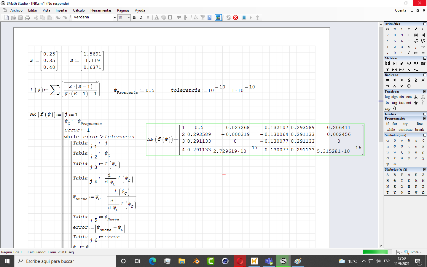

How can I do this loop while?
what am I doing wrong?
NR.sm (8.06 KiB) downloaded 1038 time(s).

I think it already came out, but how do I make the numbers that are almost 0 not appear as 2.72 * 10 ^ -17?

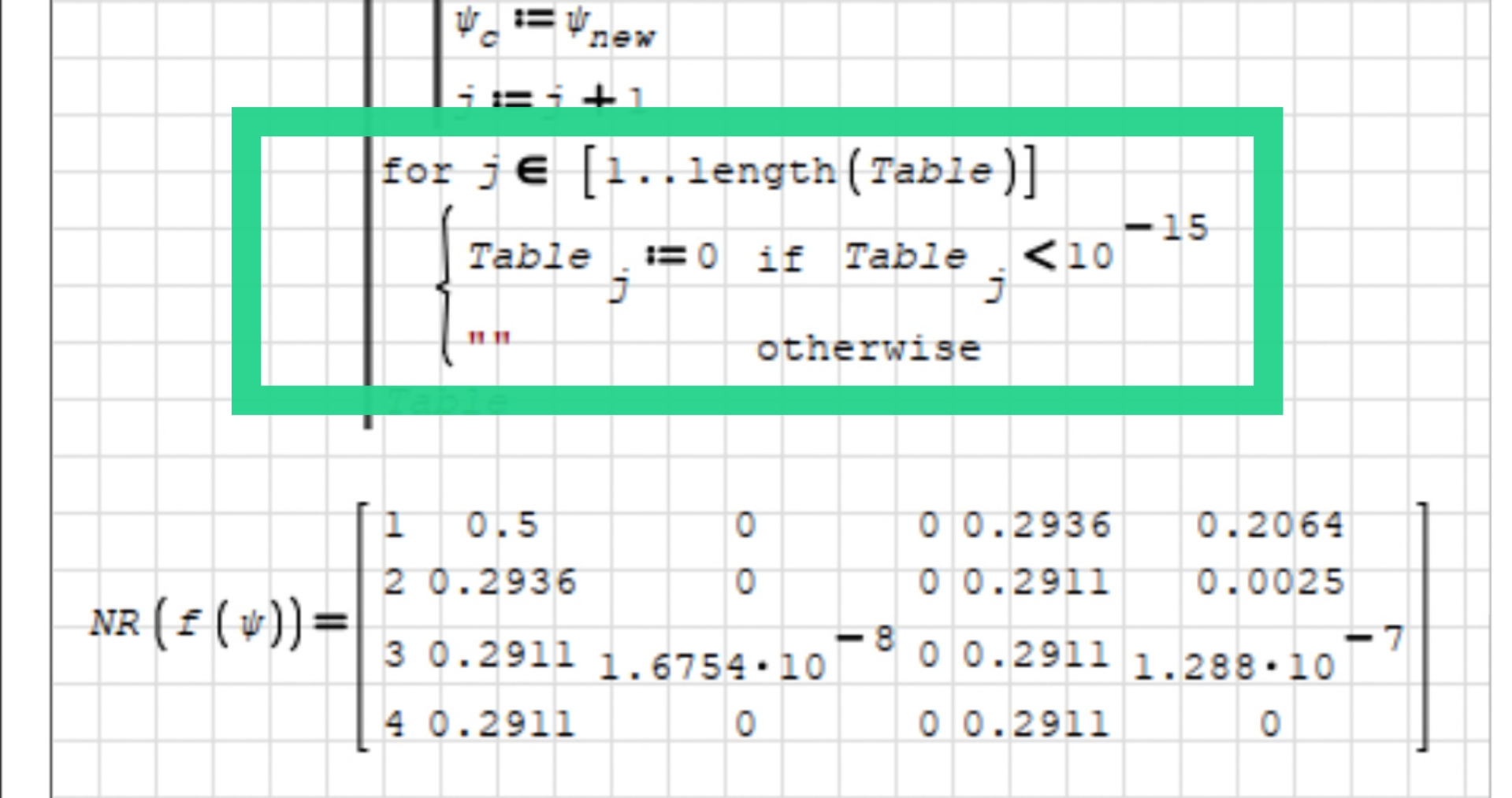

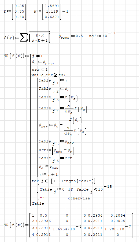

#3 Posted: 2021/9/11 15:23:39
598 likes in 1,380 posts.
Add a check for every element if they are lower than something.
And if they are, make them zero.
Erick Valentino 2021/9/11 15:40:00
what function does this have?
Thank you so much

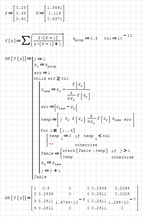

#5 Posted: 2021/9/11 16:09:46
That is cases(), it is in Custom Functions plugin.
I would prefer to write your algorithm like attached.
It is just my preference by the way.
NR_r1.sm (9.6 KiB) downloaded 1035 time(s).
