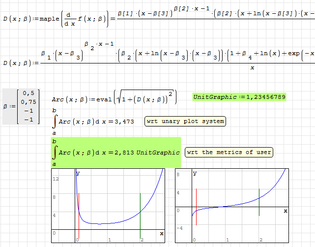

Hi Jean,
in which version did you prepare this example?
I use the last beta version, but I get a error 'x-not defined'
Thank you and best regards,
Andrey
#3 Posted: 2019/2/3 12:25:36
1,443 likes in 2,935 posts.
It is probably because MapleTools returns β[#] instead of el(β,#)

"It is probably because MapleTools returns β[#] instead of el(β,#)"
Thank you, everything works without maple
#5 Posted: 2019/2/3 16:45:38
1,554 likes in 1,864 posts.
MapleTools updated. Issue fixed.
... from Smath 6179.
As Davide points out, your latest freaks Maple !

Hi Jean,
thank you for the answer!
And thank Uni for adjusting of the plugin!
It works now
