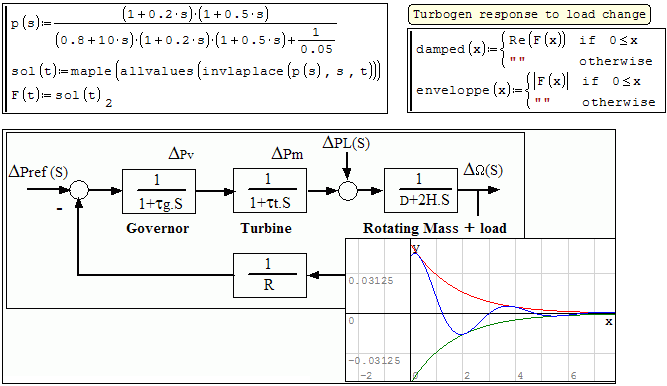

Thanks Davide for the WS.
"assume" is often needed as well as "real".
The most common is "allvalues". It expands
the more general RootOf.

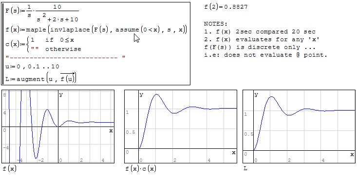

#23 Posted: 2017/8/29 07:30:28

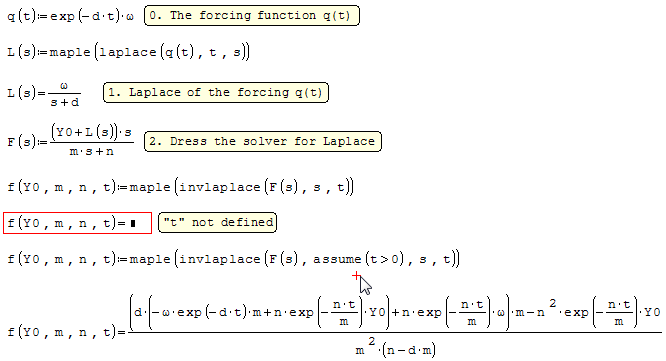

#24 Posted: 2017/8/29 08:13:02

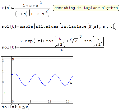

Hi, this is a snippet for numerical inverse Laplace transform. You can find time response of a system expresed in F(s) form.
enjoy
