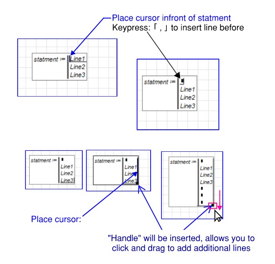

Just use the argument divider (comma or semicolon, dependent on the settings) while the cursor is at the appropriate position (line beginning or ending).

Below is a picture with regards to MarB's instructions. In addition, there is the ability to click'n-drag the statement to increase the number of line items:
Hope this helps,
- Kenny Lemens, P.E.

It worked, thank you all.

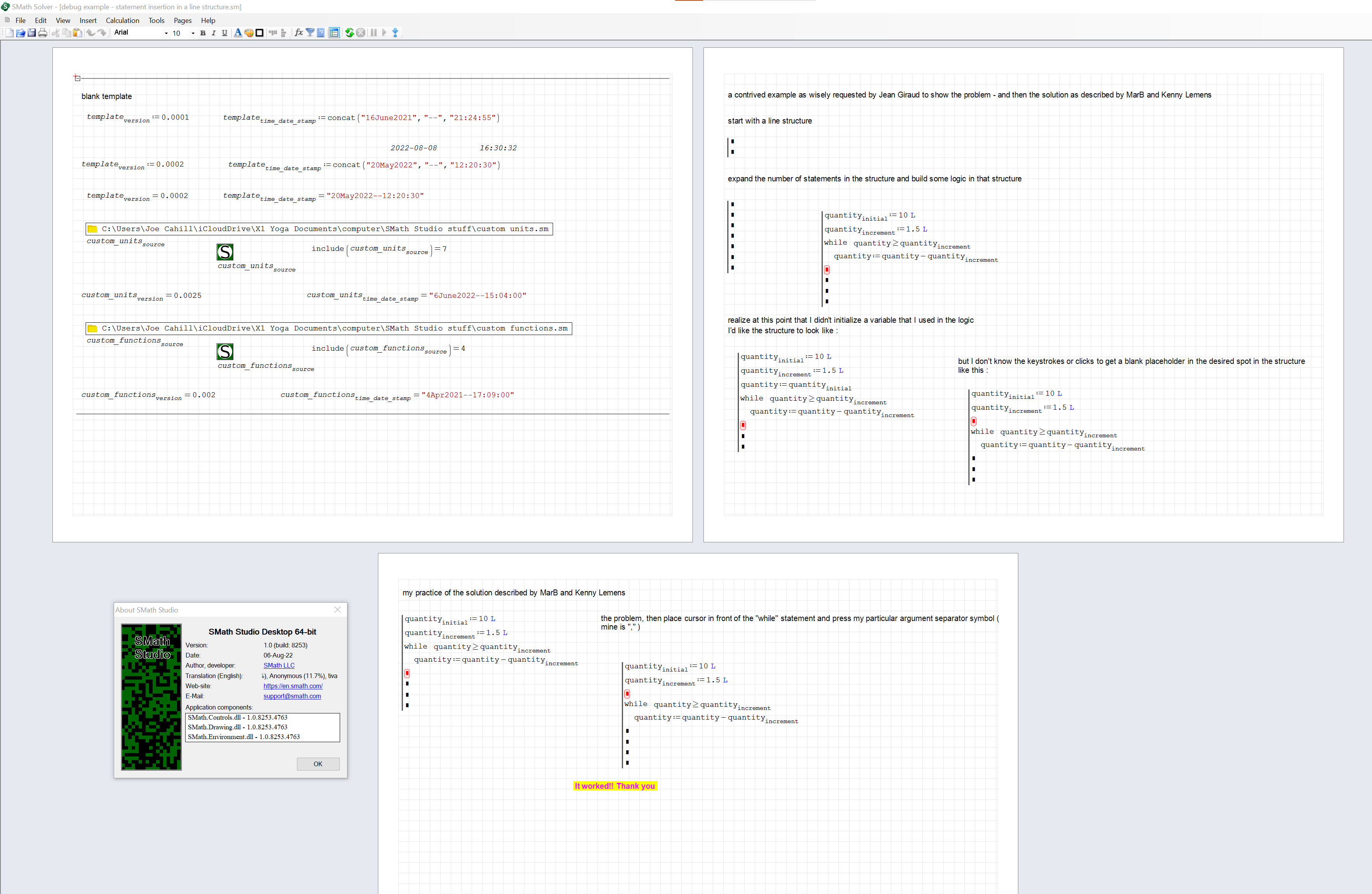

I've attamept to attach the problem example that Jean Giraud suggested would be helpful, along with the illustration of the solution that MarB and Kenny Lemens described, but my attempts appear to fail. Sorry.
debug example - statement insertion in a line structure.sm (20.61 KiB) downloaded 752 time(s).
I guess the attempts worked, in spite of the flashing red message.
Hmmm, interesting.
Here's a screen snap of it open with the version of SMath Studio shown also and a pdf ->
debug example - statement insertion in a line structure.pdf (114.49 KiB) downloaded 365 time(s).
As an afterthought, I downloaded the file I uploaded and it opened on my laptop with my installation of SMath Studio.
