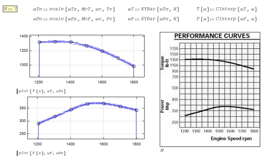

#1 Posted: 2021/6/8 18:11:10
1,078 likes in 1,749 posts.
From the textbooks to a SMath evaluable function
Digital Image Function Analysis.sm (538.87 KiB) downloaded 842 time(s).
Digital Image Function Analysis.pdf (1.56 MiB) downloaded 585 time(s).

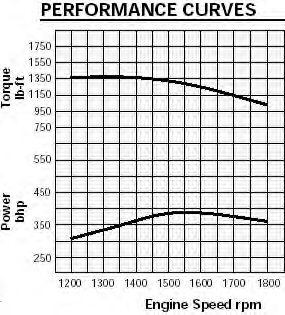

Image for the analysis:

Hi overlord. Thanks. Do you download the image "imgPerformance.jpg" and put it in the same directory than the sm file? It is the only issue specific for linux that I can see. I know, it is showed instead given the link for download. Here it is as zip file:
imgPerformance.zip (60.26 KiB) downloaded 207 time(s).

#7 Posted: 2021/6/9 18:05:00
Try this suggestion:
1. Plug one of those dirty image in Paint.
2. zap the X,Y grids.
3. Capture WinGrab and note the X, Y pixels for further scaling.
4. Insert picture, Digitize, clean ... finish project.

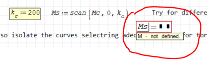

I may try to rehash an old problem that Jean helped me with in MathCAD that I could never get to work.
First, why the error in the SM file? I just downloaded and opened using Portable version on both Windows 10 and Linux.
#9 Posted: 2021/6/14 13:10:49
Hi. You can try to eval only Ms outside the plot for read the error, if it is not an specific error related with the plot.
#10 Posted: 2021/6/14 16:15:44
Ruben Sidranski
Ruben Sidranski
17 likes in 463 posts.
Ms is not defined. As you can see, I changed kc as well.
#11 Posted: 2021/6/14 17:46:10
Nope. The message says that "M" is not defined, not Ms. And M is for load the image, not for doing some process. Try this version, with the image embeded in the worksheet:
https://en.smath.com/forum/yaf_postsm71146_Approximation-of-a-functional-curve-in-a-digital-image.aspx#post71146
and check if you can update the plugins for images.

#14 Posted: 2021/6/16 08:15:51
Elsid,
My offer via Paint is valid, but delicate from too thick graph.
My other tool is via Tracer 15 [freeware]
Paste image as is in Tracer, capture at will pixels.
Each capture is stacked in vector, obviously noisy.
Once in hand, Ksmooth the Y vector ...
We have Ksmooth as a Smath utilities.
Once smoothed, spline ... Job done.
Have a good day ... Jean

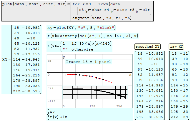

#18 Posted: 2021/6/23 12:21:39
... once pixels in hand ► Ksmooth ► final fit.
