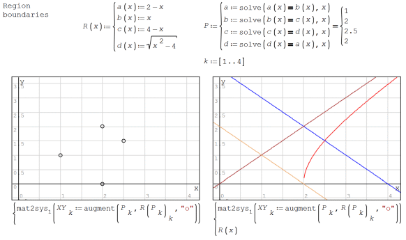

Hi. In the attached, can plot points and functions, but not both in the same plot.
Double Integral.sm (10.7 KiB) downloaded 1159 time(s).

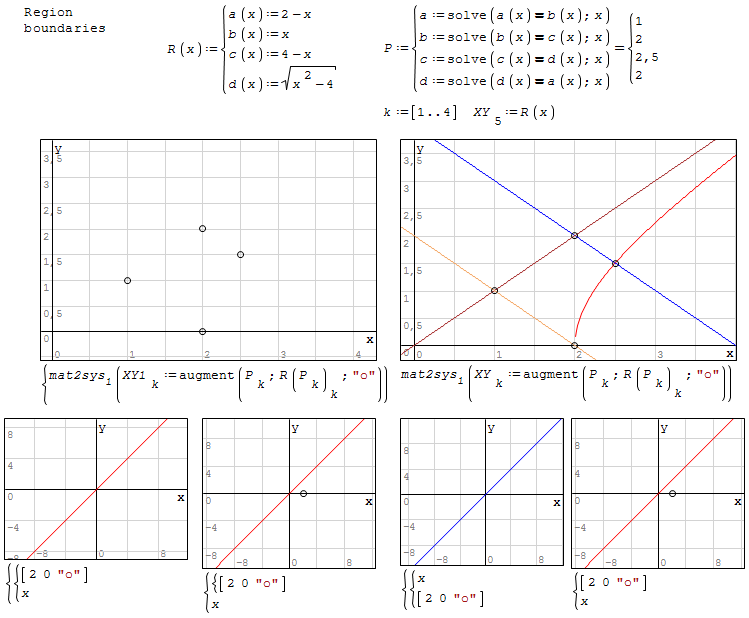

The old style works otherwise.
You can fill the region of integration.
Double Integral.sm (16.39 KiB) downloaded 1156 time(s).
Double Integral FillRegion.sm (17.83 KiB) downloaded 1127 time(s).

The behaviour of arguments in nested lists seems to be unpredictable, at least I don't see the rule.
Thus, re-arranging objects works but I don't know why.
Double%20Integral_Kr.sm (11.48 KiB) downloaded 1319 time(s).

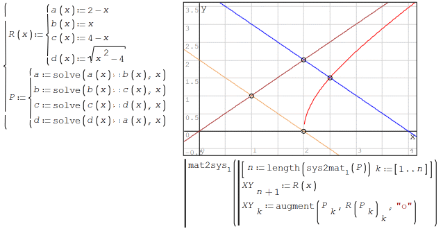

Hi Martin. Thanks for the tip. I guess that I take this form, from you suggestion:
#5 Posted: 2018/11/17 18:18:39
... personally: I prefer the more conventional form.
The example in view may fail in other instance(s).
3 in one: functions, solutions, fill-in region.
X_Y Plot wisely [Solve] Boundary.sm (39.51 KiB) downloaded 1003 time(s).
