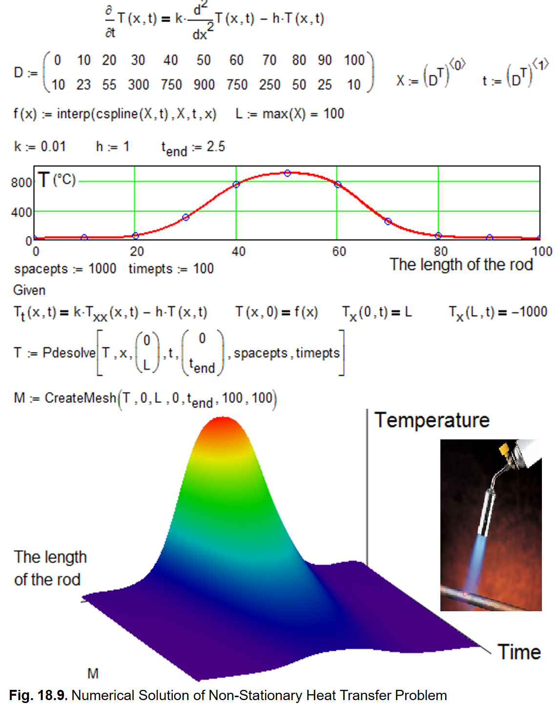

We heated the rod in the flame of a burner.
How will it cool down?
Non-stationary mode!

And what about the ICs?
We must use one numeric not symbolic method!

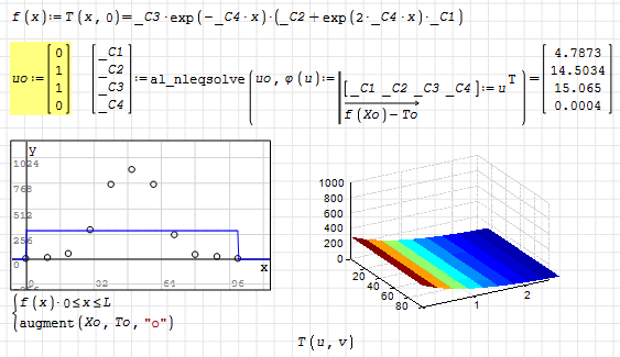

I would like as here
https://en.smath.com/forum/yaf_postst23506_Cannot-plot-T-x--y.aspx
#6 Posted: 2023/7/6 09:53:10
Thanks!
Thiele_0 Model QUICK.sm (24.5 KiB) downloaded 779 time(s).
Maths EDU [l_p_c_splines TOOLBOX] Copy.sm (584.29 KiB) downloaded 687 time(s).
These two documents are SS 6179.
Please, confirm you can open.

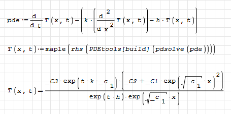

Using maple, you can try to use a maple "component" or a maple plot, which gives more flexible access to maple structured functions.

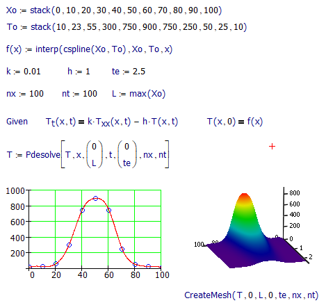

Notice that in Mathcad the border conditions for δT(x,t)/δx are not considered for obtain the solution.
With SMath, you can try to adjust the curve choosing good guess values in the yellow vector.
pdesol_num.sm (14.78 KiB) downloaded 771 time(s).
