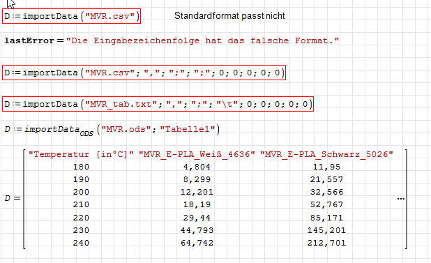

Hi, I experience problems with import of text files. ODS and Excel work.
In the attachment you find the worksheet and the data in various formats.
Import.zip (170.68 KiB) downloaded 89 time(s).

Are these similar bugs? I reported one about 5 years ago.
https://smath.com/en-US/forum/topic/kWoP42/importData__#msg127602
