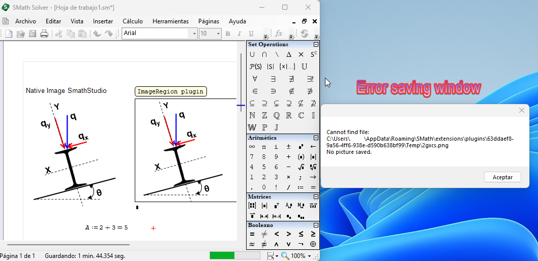

Just start another instance of SMath first, then load the other application in that.
I normally don't start two instances of the application because when closing one of the instances an error is generated in the images inserted with the ImageRegion plugin of the instance that remains open.
I hope you can fix this.

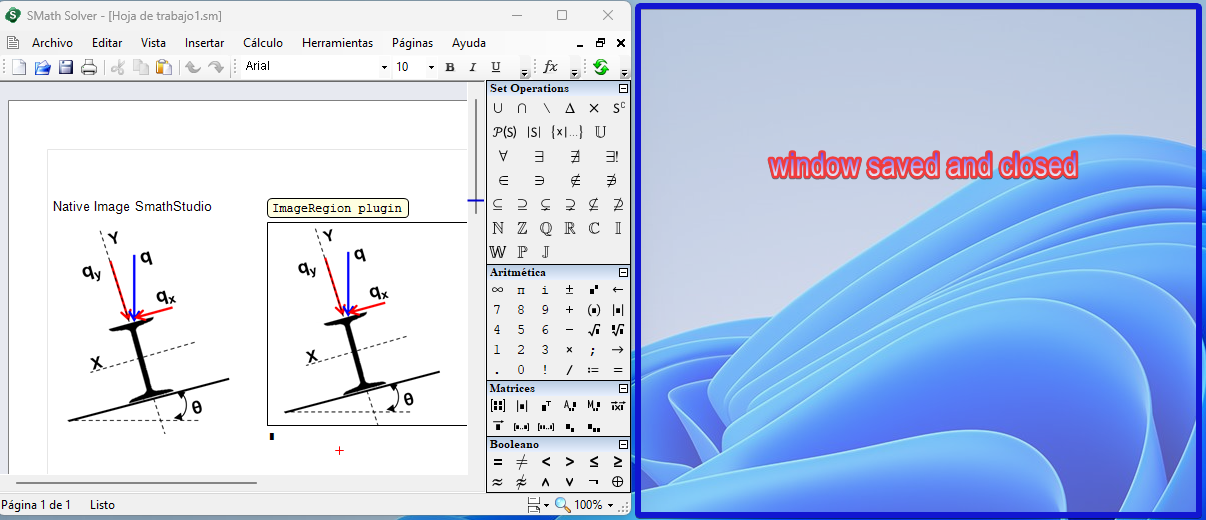

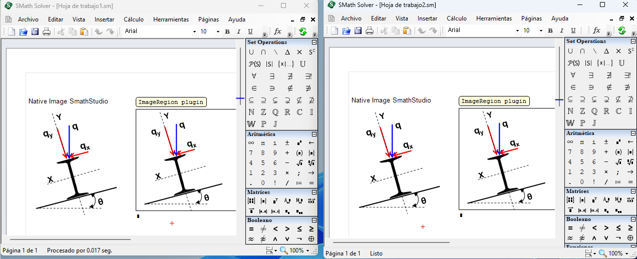

Fixed. Seems that the Release manager doesn't work currently, so the plugin can't be updated, but the code is uploaded in the SVN.
The temporary folder that contains the images generated on the fly by the plugin now has a sub-folder for each instance of the program, therefore the issue shouldn't arise anymore (BTW probably it was already reported before).
