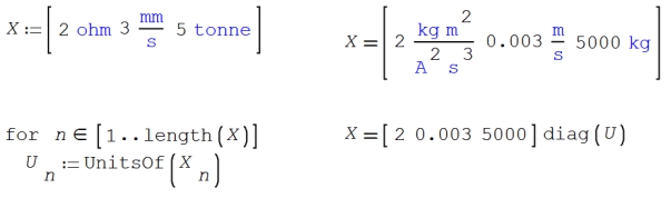

Units are not simplified (i.e. to ohms etc) from the base SI units, when they are in matrices.
This means that I can't really use a vector to return tuples from a function or display numbers with mixed units, as the units become unrecognisable.

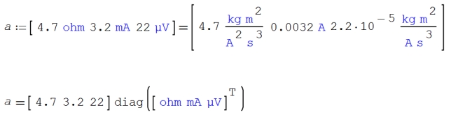

Hi. This is my workaround: in the unit placeholder put diag([unit1, unit2, unit3]^T)
sergio 2020/8/25 05:13:00, Martin_B 2020/8/25 09:21:00

Here's the catch: I want to return a tuple of two values where I don't know what the units will be.
Hi. If you want the string with the value and the unit, try this: with this post ( https://en.smath.com/forum/yaf_postst17763_Dimensions-utility.aspx ) you can seek the dimensions of an unit, further, you can add a column in the 'Dimensions matrix with the unit as string for each one dimension and return it in some function UnitString, instead the dimension name.
Or can use this if don't want to work with strings:
