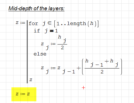

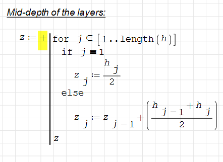

#2 Posted: 2023/12/20 00:50:59
1,443 likes in 2,935 posts.
select all > optimization > numeric
AND EITHER
z:z
OR
z:+line(...)
This is because z:line() is a procedure (something like a function, but for variables); it doesn't evaluates in place on definition, hence is completely calculated from scratch every time you need z, z[j], etc....
Using a + between the definition operator and the line() function, you don't have anymore a procedure; using z:z, it evaluates once from that point onwards.

#7 Posted: 2023/12/20 03:15:47
Fikret Atalay
Fikret Atalay
2 likes in 24 posts.
Thank you, Alvaro! I like having the lines because it makes it clearer as to which parameter I am defining. I just didn't realize it was slowing it down so much (although putting + in front of the lines makes the problem go away - sort of a win-win!).

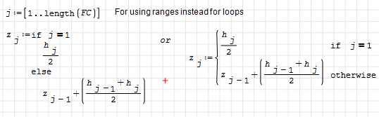

#9 Posted: 2023/12/20 12:07:29
1,123 likes in 1,795 posts.
Hi. You can eliminate all the for loops using the SMath index vectorization, which work more or less like the same concept in matlab, with cases() for having some visual separation
Seismic Site Class & Liquefaction Potential v2.sm (119.62 KiB) downloaded 1347 time(s).
