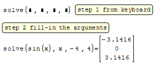

SMath Forum SMath Studio Questions Do I have to use Insert > Function in order to use solve 1 Pages (4 items) Do I have to use Insert > Function in order to use solve - Messages Go to last post #1 Posted: 2022/9/23 07:54:39 mateo 0 likes in 2 posts. Group: User I can use Solve using the command Insert > Function. But if I write the same directly without the Menu, it won't work. What could be the reason? #2 Posted: 2022/9/23 08:20:34 sergio 127 likes in 342 posts. Group: User You should check the use of capital or tiny "s". Also only if you have installed the "Maxima" plugin you have both "solve" and "Solve" that have a different solutor and also a different formsergio #3 Posted: 2022/9/23 09:28:54 mateo 0 likes in 2 posts. Group: User Thank you. I wrote solve indeed with tiny s and I don't have the Maxima plugin. However, I tried it once again today and it worked. #4 Posted: 2022/9/23 13:38:41 Jean Giraud 983 likes in 6,866 posts. Group: User 1 Pages (4 items) New Posts No New Posts
