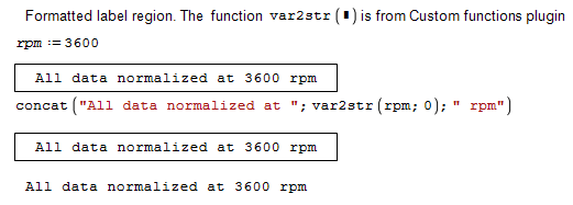

You could just place a formatted label region over the caption . This is a bit weird but it works. Use the context menu to switch off input and border.
label.sm (4.57 KiB) downloaded 687 time(s).
In newer SMath versions, you can also use a standard text region with an embedded formula, where you can suppress input display and even specify a unit.
