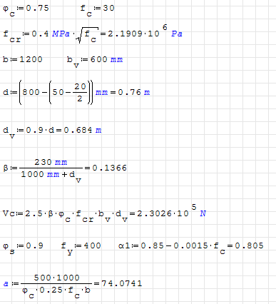

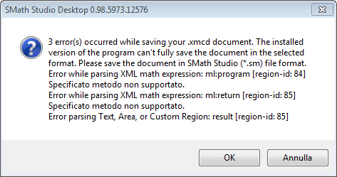

In the method
public static Term[] PrefixToPostfix(Term[] value)
I found that an exeption is thrown while parsing the UnitOperator; skipping this (that is just a workaround, there's an inconsistence to fix somewhere), it loads more functions but there are some errors in the last 2 xmcd regions (unrecognized tags ml:program and ml:return)
The patch on the UnitOperator seems that helps even here: http://en.smath.info/forum/yaf_postsm33083_Mathcad-file-import.aspx#post33083 (still missing the conversion for the "plot" region)
Reported as SS-2341

edit: Screenshot of the error message
Show Spoiler
please don't delete any post if it contains bug infos
#10 Posted: 2016/6/27 19:42:13
1,443 likes in 2,935 posts.
These are other missing attributes from the xmcd schema. Moved your question here since it is the same issue (about other elements).
