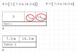

I have this display problem when trying to pass
a matrix to a Table.
Table_Region_Problem.sm (11.47 KiB) downloaded 1384 time(s).

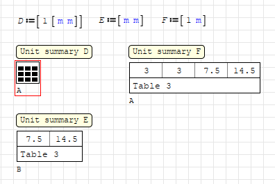

Unit summary doesn't work as it should either.
Maybe these are bugs. Regards
