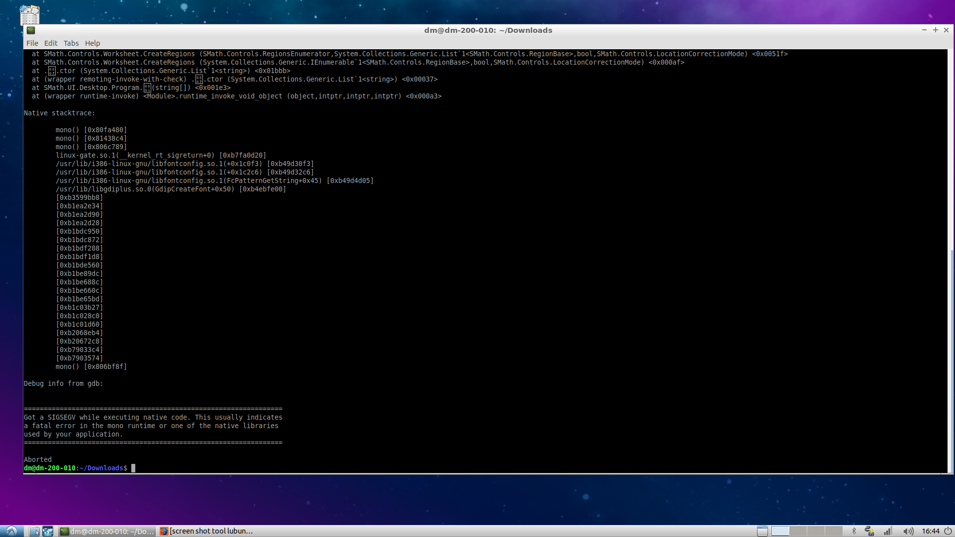

a fatal error in the mono runtime or one of the native libraries
used by your application.
Aborted

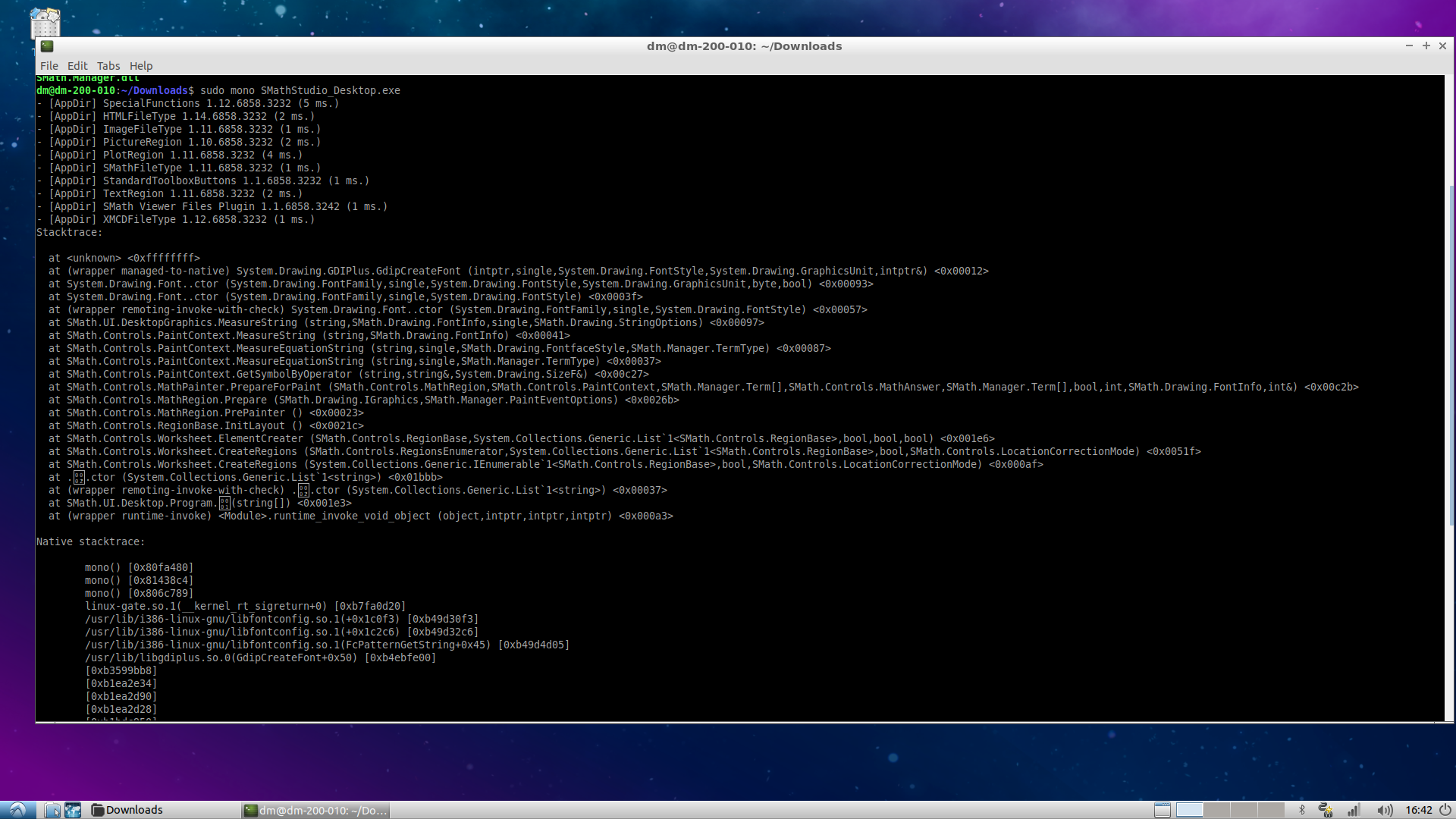

I started with 6858 and got some font errors. After installing a few fonts - e.g. Andale - I got less errors, but the application still crashed. Then I tried 6839 getting the same error messages. Version 6670 seemed to work initially even though a X11 error was reported. Only after loading the above mentioned examples SMAth crashed. Sorry, I skiped testing 6671. Today I tried 6671 on Mint. The same X11 error is still there, but Newton example loads without crashing.
6858 AND 6839 on Mint
No X11 error on startup, but GDI+ error
<<<<<<<<<<<<<<<<<<<<<<<<<<<<<< 6858 >>>>>>>>>>>>>>>>>>>>>>>>>>>>>>>>>
jro@jro19 ~/Programs/SMathMono_6858 $ mono SMathStudio_Desktop.exe
- [AppDir] SpecialFunctions 1.12.6858.3232 (6 ms.)
- [AppDir] HTMLFileType 1.14.6858.3232 (3 ms.)
- [AppDir] ImageFileType 1.11.6858.3232 (1 ms.)
- [AppDir] PictureRegion 1.10.6858.3232 (3 ms.)
- [AppDir] PlotRegion 1.11.6858.3232 (4 ms.)
- [AppDir] SMathFileType 1.11.6858.3232 (0 ms.)
- [AppDir] StandardToolboxButtons 1.1.6858.3232 (1 ms.)
- [AppDir] TextRegion 1.11.6858.3232 (1 ms.)
- [AppDir] SMath Viewer Files Plugin 1.1.6858.3242 (2 ms.)
- [AppDir] XMCDFileType 1.12.6858.3232 (1 ms.)
Unhandled Exception:
System.ArgumentException: The requested FontFamily could not be found [GDI+ status: FontFamilyNotFound]
  at System.Drawing.GDIPlus.CheckStatus (Status status) <0xb491ac90 + 0x007ef> in <filename unknown>:0
  at System.Drawing.Font..ctor (System.Drawing.FontFamily family, Single emSize, FontStyle style, GraphicsUnit unit, Byte gdiCharSet, Boolean gdiVerticalFont) <0xb298d528 + 0x0009f> in <filename unknown>:0
  at System.Drawing.Font..ctor (System.Drawing.FontFamily family, Single emSize, FontStyle style) <0xb298d4d8 + 0x0003f> in <filename unknown>:0
  at (wrapper remoting-invoke-with-check) System.Drawing.Font:.ctor (System.Drawing.FontFamily,single,System.Drawing.FontStyle)
  at SMath.UI.DesktopGraphics.MeasureString (System.String text, SMath.Drawing.FontInfo font, Single width, SMath.Drawing.StringOptions format) <0xb275da00 + 0x00097> in <filename unknown>:0
  at SMath.Controls.PaintContext.MeasureString (System.String text, SMath.Drawing.FontInfo font) <0xb275d970 + 0x00041> in <filename unknown>:0
  at SMath.Controls.PaintContext.MeasureEquationString (System.String text, Single size, FontfaceStyle style, TermType type) <0xb276bc88 + 0x00087> in <filename unknown>:0
  at SMath.Controls.PaintContext.MeasureEquationString (System.String text, Single size, TermType type) <0xb276bc28 + 0x00037> in <filename unknown>:0
  at SMath.Controls.PaintContext.GetSymbolByOperator (System.String oper, System.String& text, System.Drawing.SizeF& size) <0xb276a3d8 + 0x00c27> in <filename unknown>:0
  at SMath.Controls.MathPainter.PrepareForPaint (SMath.Controls.MathRegion region, SMath.Controls.PaintContext ctx, SMath.Manager.Term[] input, SMath.Controls.MathAnswer answer, SMath.Manager.Term[] units, Boolean inputDataVisibility, Int32 currentTermIdx, SMath.Drawing.FontInfo font, System.Int32& middleLine) <0xb274e000 + 0x00c2b> in <filename unknown>:0
  at SMath.Controls.MathRegion.Prepare (IGraphics g, SMath.Manager.PaintEventOptions e) <0xb2768218 + 0x00243> in <filename unknown>:0
  at SMath.Controls.MathRegion.PrePainter () <0xb27681e0 + 0x00023> in <filename unknown>:0
  at SMath.Controls.RegionBase.InitLayout () <0xb2767f90 + 0x0022c> in <filename unknown>:0
  at SMath.Controls.Worksheet.ElementCreater (SMath.Controls.RegionBase region, System.Collections.Generic.List`1 regions, Boolean makeCurrent, Boolean batchProcessing, Boolean invalidateRequired) <0xb27656b8 + 0x001e6> in <filename unknown>:0
  at SMath.Controls.Worksheet.CreateRegions (SMath.Controls.RegionsEnumerator enumerator, System.Collections.Generic.List`1 regions, Boolean showProgress, LocationCorrectionMode locationCorrection) <0xb2764128 + 0x00517> in <filename unknown>:0
  at SMath.Controls.Worksheet.CreateRegions (IEnumerable`1 newRegions, Boolean showProgress, LocationCorrectionMode locationCorrection) <0xb2763ae0 + 0x000af> in <filename unknown>:0
  at ...ctor (System.Collections.Generic.List`1 ) <0xb2be8fb8 + 0x01bbb> in <filename unknown>:0
  at (wrapper remoting-invoke-with-check) .:.ctor (System.Collections.Generic.List`1<string>
  at SMath.UI.Desktop.Program. (System.String[] ) <0xb78dd170 + 0x001e3> in <filename unknown>:0

Just installed Lubuntu 18 LTS on an HP Stream mini and wanted to install SMath (0_99_68658). Installed mono and double clicked the .exe and is tries to load, then nothing. Tried in terminal in mono. Got a set of errors about missing font library. Tried again to do a scree capture and had a slightly different error. Attached screenshots. Also said: debug info from gdb:
Got a SIGSEGV while executing native code. This usually indicates
Show Spoiler
mod: topic moved in the existing thread
