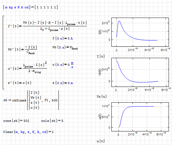

I attempt to convert a Prime sheet to SMATH. The Prime sheet uses a solve block with "Odesolve" (pdf attached). I tried using "ODE2" but I do not have Maxima installed.
Is there another route?

Hi. You can try this. Even this returns functions for I(t), Vr(t) ... there is a unit issue. But you can use the values in rk with cinterp for reconstruct the functions with units.
Rail Gun ODE.sm (22.74 KiB) downloaded 1075 time(s).
