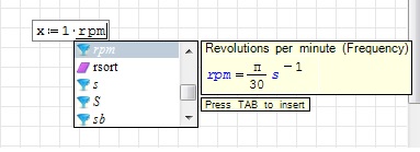

I am new using sMath Studio so this is likely to be something I am doing wrong but I haven't been able to make sense out of it so I'll just report it.
rpm is defined as pi/30 (1/s) . That is what it shows when I hover over a variable defined with that unit.
However, according to wikipedia and my common sense, rpm = 1/60 (1/s or Hz) = 2*pi/60 (rad/s) = pi/30 (rad/s)
That means that every time I use rpm the result is off by 2*pi which is quite annoying.

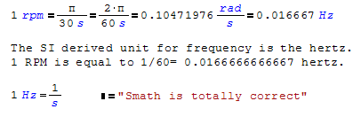

#9 Posted: 2016/9/7 14:08:42
1,443 likes in 2,935 posts.
1 rpm = 1 rev/min = 1/60 rev/sec
And it is exactly how it is defined in SMath
But 1 revolution is equal to 360° (2pi)
If you don't need relationships with the angles (the 2pi factor), simply redefine rpm

I think that the root of the problem is that rpm is not an SI unit. Therefore you can consider it to be either a unit of frequency (of rotation) or a unit of angular speed.
If you consider it to be a unit of frequency (angular frequency) then 1 rpm = 1/60 Hz follows immediately. If not then you get the 2*pi factor (what sMath Studio does).
I have been looking for some information online and in most of the webpages I found they consider it to be a unit of frequency. Which makes sense to me since frequency is event for unit of time and rpm is revolution (event) for unit of time (minute).
By the way, even sMath Studio (once you hover over the unit) displays it as a frequency (not angular velocity).
Christopher Bietz 2016/9/9 11:10:00
#16 Posted: 2016/9/9 09:24:11
1,355 likes in 2,271 posts.
Good point indeed. This should be changed. It also applies to some other units. This can be seen best in the insert unit dialog. There, some categories are missing:
angular velocity
angle
The angular units currently are categorized as dimensionless.
Filed as SS 2395
#17 Posted: 2016/9/9 22:20:41
To deplease previous comments, Smath is totally correct
in this thread. It just happened that some i... at the
SI system decided not to count rpm on fingers but on
fractional fingers. End of it, Smath OK !
