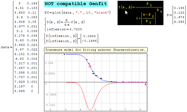

Data set from Art [Mathsoft Collaboratory], unexplained, no abstract.
Bonus in this Smath document: Min/Max Golden ratio.
Seemingly, the fit may be adjusted so that the min derivative be
exact wrt the reference start point [3, 0.164] ... not offered.
Genfit Difficult Pharmacokinetics.sm (25.46 KiB) downloaded 1049 time(s).
#2 Posted: 2018/8/15 10:18:52
... => here is !
Genfit Difficult Pharmacokinetics.sm (25.81 KiB) downloaded 1079 time(s).
