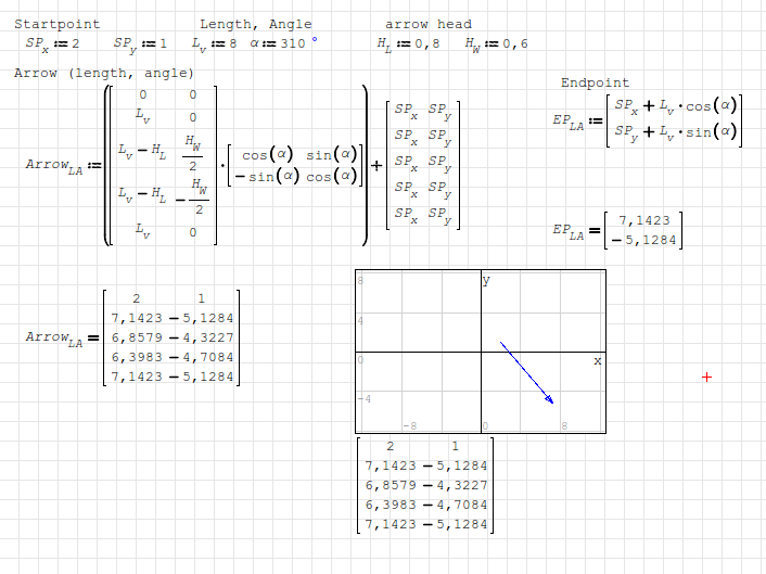

Dear experts,
Sorry if this question is stupid, but I am new to SMATH.
In order to plot some simple vector diagrams (using the SMATH built in diagram) I did the following.
I want to plot the vector from a given start point with given length and angle.
So for the arrow I created a polygon, rotaded and moved it. This works quite well. I als can put the formulars into the plotting input area.
But it would be nicer to define a function e.g. Arrow(start_x; start_y; length; angle).
Is this possible? What would be the syntax?
Is there maybe a smarter way of doing this?
Thanks in advance!
Ralf
arrow1.sm (11.18 KiB) downloaded 1034 time(s).

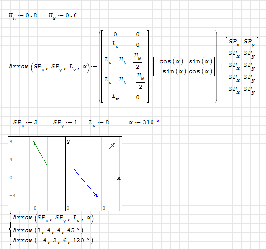

Hello Ralf,
welcome in the community
Simply put a function name on the LHS (left hand side) of the assignment operator
![2018-03-24 16_56_50-SMath Studio - [arrow1.sm_].png](/zh-Hans-CN/files/Download/MgCoWa/2018-03-24-16_56_50-SMath-Studio---[arrow1.sm_].png)
arrow1 (r1).sm (12.64 KiB) downloaded 1035 time(s).
Once you have done it if you want to rename a variable inside the function you can do it at once using the F8 key when the text cursor is inside the variable you want to rename.
