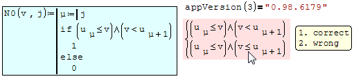

I notice one instance if/otherwise does not work vs if/else.
Reported, not acknowledged ... maybe more than one instance.

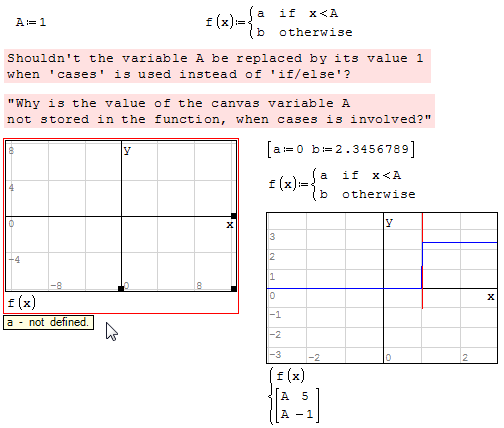

I really don't want to play silly games with you anymore.
I asked a simple question:
"Why is the value of the canvas variable A not stored in the function, when cases is involved ?"
Your answer has absolutely nothing to do with my question.
Convince yourself, try the right/wrong code in De Boor Colibri.
It may have to do with another next possible not silly visit/question.
Spline De Boor [Colibri].sm (39.34 KiB) downloaded 829 time(s).

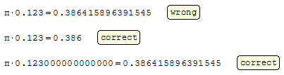

A CAS like Smath and others do not know if
0.123 is exactly = 0.123000000000000
I'm not aware of such an option in Smath
Example from Mathematica 4.0
#24 Posted: 2018/5/2 08:57:09
Explained otherwise in Mathcad/Mathsoft
x^1/2 will output 250 floating point decimals [1/2 is exact]
x^0.5 will output 15 decimals [0.5 is unknown]

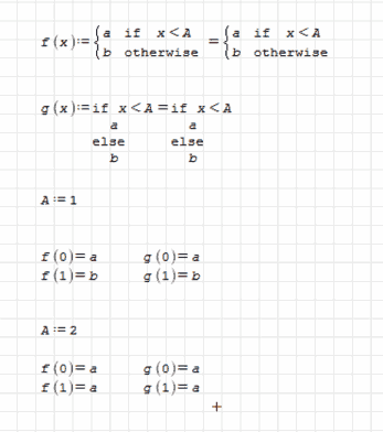

Originally Posted by: Alyles
Quote
The difference comes when the value of A changes after the definition of f(x) and g(x).
For g(x) the original definition of A:=1 remains. However, for f(x) the value of A changes.
I see that the problem is caused by the definition of the variable A, before the functions, changing the definition of this variable after the definitions of the functions, the problem is solved.
This indicates to us that we must be very careful when programming functions when some of the variables that integrate in them have already been defined previously, because we could arrive at erroneous results
cases_ok_cbg.sm (7.02 KiB) downloaded 997 time(s).

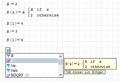

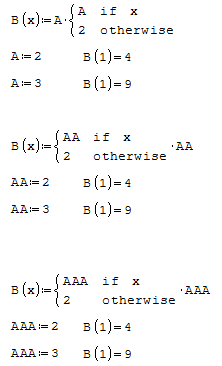

Another example:
The first A is replaced by its value, the second is not.
Not really intuitive or obvious, in my opinion.
