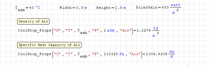

I'm putting together a sheet using the CoolProp wrapper
It generally works really well except for the following
Where I'm getting strange units for the Specific Heat capacity of Air
I've tried overriding the units but still don't get what I want (J/kg/K)
I've attached an extract from the sheet --> UnitsProblem.sm (7.04 KiB) downloaded 1200 time(s).
Probably a really simple answer but I can't seem to find it !!

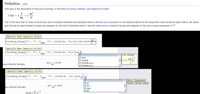

Can't reproduce. J/(kg*K) works. Paste 'J/{'kg*'K} to the square placeholder to the right of the unit when the region has focus.

You are all correct (I knew the answer was going to be obvious ) , pasting in the units J/kg K works fine
Its just that Gy/K seems an odd default unit
Thanks for your help
