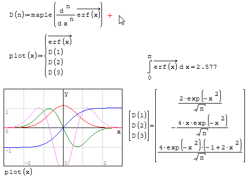

WroteHi Tom. maple() knows how to eval diff because, as plugin, Viacheslav (uni, plugin author) know how to handle the function el(A,k). But notice what happen with an unknoun function, like El(A,k). So, problem here is what to do with the SMath el(A,k) with the operator diff.
