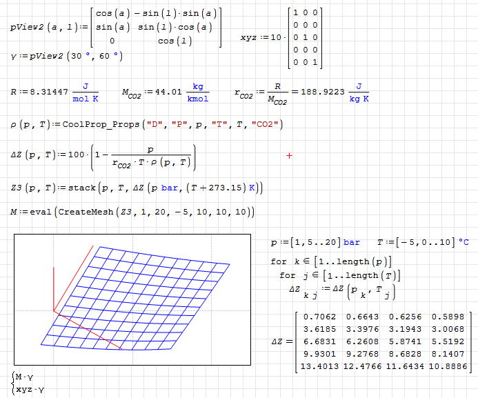

1 likes and 1 dislikes in 15 posts.
i would like to create 3d plot of compresibility with p and T as axis. How can i do that?

#2 Posted: 2025/12/14 01:40:46
1,123 likes in 1,795 posts.
Hi. This is a way.
Z-CO2.sm (16.56 KiB) downloaded 649 time(s).
Edited 2025/12/14 05:15:11

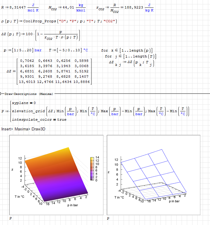

Wow, thanks.
i would like to use char3D or Maxima plot. Is the procedure same?
#4 Posted: 2025/12/14 12:32:34
Hi Tomas. I assume so. And also in maple, dislin, and others. But I'm not skilled enough in those methods to show you the most effective way to use them.

#6 Posted: 2025/12/17 22:17:20
1,355 likes in 2,271 posts.
The plots can be rotated with the mouse, yet there is a considerable time lag.
3d.sm (219.19 KiB) downloaded 625 time(s).
Edited 2025/12/17 22:18:37
Tomas Novotny 2026/2/1 07:39:28
#7 Posted: 2025/12/18 10:50:26
Tomas Novotny
Tomas Novotny
Awesome,
thanks Martin!
