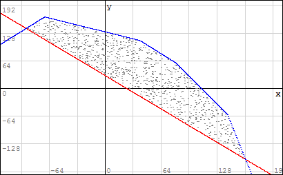

#4 Posted: 2019/9/28 13:21:02
2D Plot Discontinuous [min(,)].sm (14.78 KiB) downloaded 869 time(s).
#5 Posted: 2019/9/28 14:31:28
... Dichotomy added for solving in the complex region.
2D Plot Discontinuous [min(,)].sm (27.31 KiB) downloaded 854 time(s).
#6 Posted: 2019/9/28 18:35:33
filling the loft added.
2D Plot Discontinuous [min(,)].sm (44.7 KiB) downloaded 870 time(s).

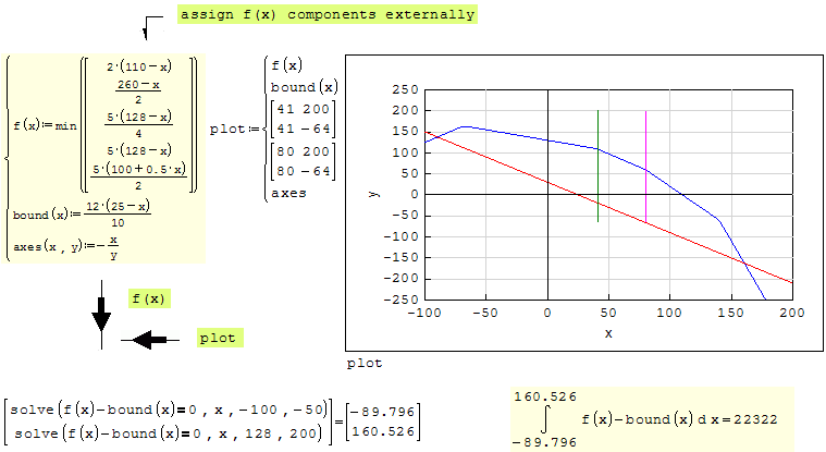

#8 Posted: 2019/10/1 08:35:03
but how do you set your graph axis
1. Dispose the plot from plotting using Smath @ QuickPlot
zoom, shift left/right, up/down ...
2. Plot on the X_Y, set the X ± limits, Y ± limits.
3. plot ... 4. specify the traces from "list"
As simple as explained, no sweat ! ... Last plot.
2D Plot Discontinuous [min(,)].sm (44.49 KiB) downloaded 882 time(s).

#11 Posted: 2019/10/1 23:55:59
I think that you are missing the point of my query- to be able to control and constrain the region of the plot.
You don't have a document, then no query ... is it ?
Easy to constrain the @ quick plot from "if/otherwise"
