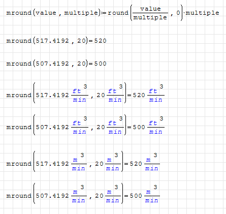

I would like to have the answer "round" to the nearest XXX. In this example, I would like an answer that gives 520 and another that gives 500
I do not want to truncate to get the 500 as I may get 589 and would like to round up
Apparently, units are part of the problem

Something like this?
ElSid 2016/4/28 15:48:00, frapuano 2016/4/28 17:24:00

New built-in function, Round? Notice the capital "R"
Thanks for the work around

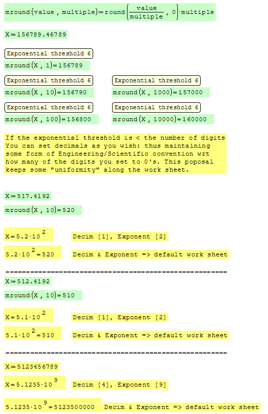

#8 Posted: 2016/4/29 10:41:13
