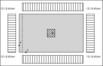

I'm using SMath to create simple structural engineering calculations.
I'd like to add sketches/visualizations of the calculated structure.
What would be the best tools to achieve this?
Here's an example of what I'm trying to do.
Best regards, Olli
What would be the best tools to achieve this ?
Otherwise suggestion.
1. As many grid as you want
2. Range the ± span
3. Display the XY points from calculation.
If that will make you happy ... please let's know.
