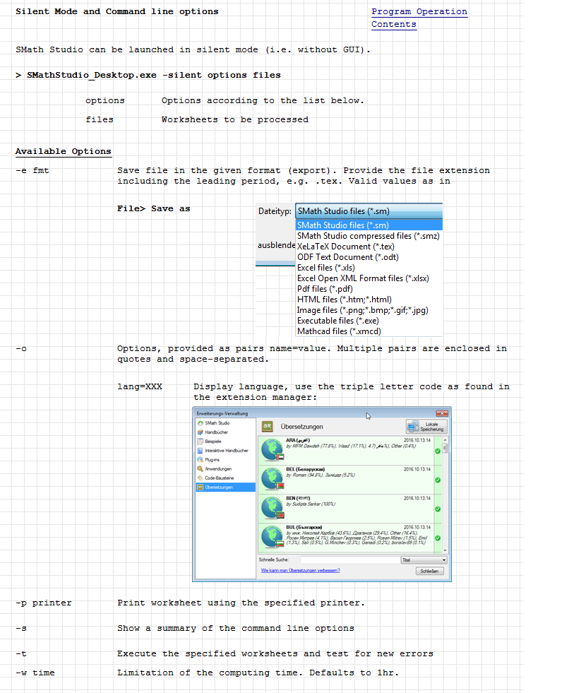

I know it's possible to run Smath from the command line and save as a specific output. What I am not sure about is whether or not you can pass parameters into the sheet using -o.
If you look in the reference book under Program Operation -> Silent Mode and Command Line Options you will get more info.

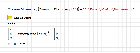

So I was able to do this in a couple steps.
I put my inputs into a file called "input.txt". Then I created a .sm called "calc.sm" that read input from the input.txt file and performed a calculation.
The command line looked like this:
I have attached the .txt, .sm and .pdf files as well.

Perhaps improving on this concept a bit. I've added some commands to point the current working directory to the document directory. This way you can save the input.txt and calc.sm in the same folder. That way you could call:
SmathStudio_Desktop.exe -silent pathtosmfile -e pdf
and as long as the input file is in the same folder you don't have to point to the absolute path of the file. This makes it more portable.
calc.sm (3.82 KiB) downloaded 696 time(s).
