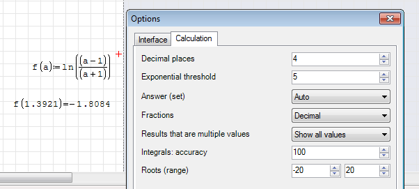

I can't replicate the issue. Maybe you have something different in SMath settings (Tools > Settings... > Calculation > Answer).

Thank you for your reply. I have tried to replicate it again myself but I have been unable to as well. I will find the worksheet it originally happened in and will try to post the issue.
