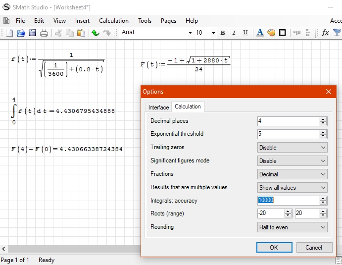

WroteWhen trying to solve the following definite integral using Smath, the result returned by Smath is incorrect. Can somebody help me, please?
int(1/sqrt((1/3600)+(0.8*t)),t,0,4)

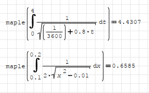

Try to use maple or maxima plugin.

Answer and result are via in post # 4 above.

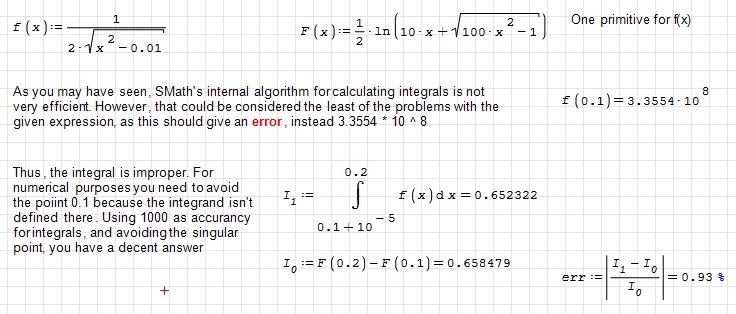

Hi. The problem with your example, now, isn't the bad integration, it's that it give you a number, not a an error. Notice that the integrand isn't continue at x = 0.1, it's undefined or infinity, because you divide by zero there.
As Overlord points, you can use Maple or Maxima for handle this kind of problems.

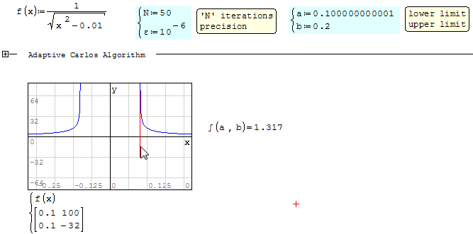

WroteI have the same problem again with this definite integral.
Page17 Integrate Carlos.sm (88.08 KiB) downloaded 1596 time(s).
In some instances, Adaptive is of no profit, but not detrimental.
1. ODE solvers are integrator [visit Alvaro/Viacheslav example]
2. FD [Finite Differences] are very true for data set, insensible to noise.
3. The Romberg kernel allows independent acc [n] for each integration.
Most profitable for long range of the variable of integration.
Please, don't hesitate for more ... Jean
Integral COMPANION Adaptive Romberg-Simpson(f,a,b,n).sm (270.48 KiB) downloaded 1557 time(s).
