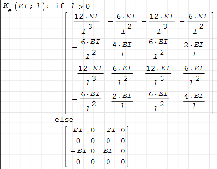

In the 1D beam analysis application BeamFEA, I use hinge elements for rotary dof release (to insert a hinge in the beam). They connect coincident nodes of adjacent beam elements.
In the 1D case, the element matrix is just parametrized by the stiffness EI and the length l. The dofs are w1, phi1, w2, phi2. A hinge element is generated if l=0. Then the EI value is taken als spring stiffness between the w dofs of the nodes. This means that equal w for both nodes is not enforced by reduction of the system but by a penalty term.
![2022-04-21 09_52_31-SMath Solver - [BeamFEA.sm_].png](/zh-Hans-CN/files/Download/yv8ATM/2022-04-21-09_52_31-SMath-Solver---[BeamFEA.sm_].png)

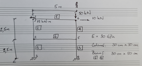

WroteI verified the results in the attached file with some 2D structural analysis software and it appears to be correct correct. Take a look and let me know.
I made some mistakes creating the stiffness matrices for rigid-hinged and hinged-rigid. In my post I edited the image. What was wrong? Well, as it was new to me this stiffness factor of 6 for the rotation around the hinge, I tested and found that it was non-sense, because the adjacent member rotating would not introduce displacements in the hinged element. (Further considerations like friction (end-moment) transmitted through the hinge could be studied, if relevant).
For now I have made tests with this simple model of 6 members. Beam 6 was tested for rigid-rigid, rigid-hinged, hinged-rigid, and hinged-hinged conditions. Comparing with FTOOL (recommended! very simple and useful tool) I all those 4 cases, I've found the same results for the x, y displacements and z rotations with 4 significant digits each (probably more but didn't look at).
Please comment if you test more complex models and loads.
