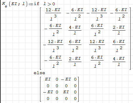

In the 1D beam analysis application BeamFEA, I use hinge elements for rotary dof release (to insert a hinge in the beam). They connect coincident nodes of adjacent beam elements.
In the 1D case, the element matrix is just parametrized by the stiffness EI and the length l. The dofs are w1, phi1, w2, phi2. A hinge element is generated if l=0. Then the EI value is taken als spring stiffness between the w dofs of the nodes. This means that equal w for both nodes is not enforced by reduction of the system but by a penalty term.
![2022-04-21 09_52_31-SMath Solver - [BeamFEA.sm_].png](/ru-RU/files/Download/yv8ATM/2022-04-21-09_52_31-SMath-Solver---[BeamFEA.sm_].png)

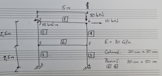

Hi wb.c,
Attached the corrected worksheet. I modified three things:
1. Connectivity for the three rigid-hinged bars. They must be coherent with the elementary matrix: start node is rigid and the end node is hinged.
2. Rotation value must be assigned as a constraint, otherwise you will have a singular Kr matrix. (there is a previous comment that I did on this post)
3. Cosinus formula should be avoided for angle calculations, as cos(alpha)=cos(-alpha), I think that the best way is to use xy2pol. (For example, for the vertical bar, if you change the node order, you will obtain 90 deg as well (instead of the correct value of -90 deg with xy2pol)).
I attached a comparison with a model made in FTOOL to validate the results (different than yours, perhaps because the condition of bars 1, 2, 3 is hinged-hinged).
Regards!

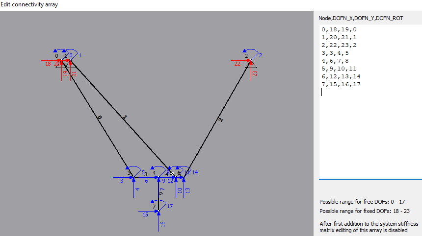

Alvaro,
Thanks for taking a look. I think we should be able to accommodate a hinged-hinged case through the means of a (pinned support)-fixed end--hinged end.
I'm using a program called LinPro 2.7.5, it is a free static and dynamic frame analysis program. https://www.thestructuralengineer.info/software/linpro-275
It handles this case quite well.
It allows you to implement a Study Mode, which shows you the step by step process the program is taking to solve the system.
A couple of notes regarding the program as apposed to what I've seen in other places:
-The modified local stiffness matrix for various member end release conditions seems to be different from what I found in my text book (Matrix Methods for Advanced Structural Analysis - Papadrakakis & Sapountzakis)
For example: Where you might expect to have 3EI/L^3, it seems to have 36EI/L^3, so I'm not sure what exactly they are doing to obtain the modified local stiffness matrix
-The program also always restricts the "fixed" constraints to the end of the DOF numbering.
So what I am trying to do is replicate the frame analysis by FEM, but for this specific case and then be able to apply a load at 360-degrees in order to find the worst case for each "strut".
This can be done without FEM, with just trig and statics, but only up to a certain number of unknowns. So hence the FEM method.

For the sake of simplicity, I eliminated some of the automated vector assemblies, as I didn't want to spend too much time trying to figure a good way to work with the DOFs as they are shown in LinPro.
Assembly Vector - Manual
Elimination Vector - Manual
Force Vector (global) - Manual
They start with 0, SMath with 1, so keep that in mind.
What they do is restrict the fixed DOFs to the end of the DOF numbering.
Now, my K (global) matches the result from LinPro exactly.

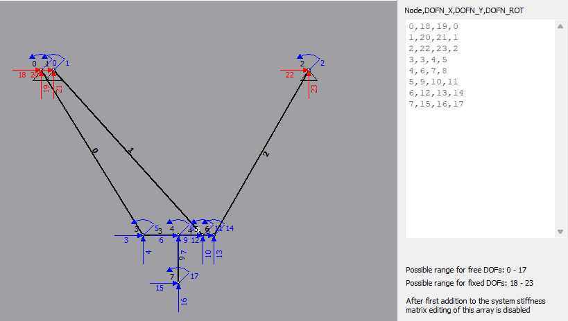

There was some interesting things that had to be done to make that happen:
As Jean has pointed out in the past, the order of matrix multiplication has varied results.
It seems that for this configuration:
![2023-03-08 17_23_58-SMath Solver 1.0.8348 - [New Frame FEM Example.sm_].png](/ru-RU/files/Download/nhTBqC/2023-03-08-17_23_58-SMath-Solver-1.0.8348---[New-Frame-FEM-Example.sm_].png)
I could not get the global k matrix to match the results in LinPro.
I ended up arranging it like this:
![2023-03-08 17_24_09-SMath Solver 1.0.8348 - [New Frame FEM Example - Updated.sm_].png](/ru-RU/files/Download/zy4hgV/2023-03-08-17_24_09-SMath-Solver-1.0.8348---[New-Frame-FEM-Example---Updated.sm_].png)
And it worked.
