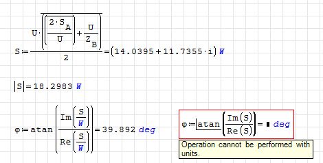

Any solution to this units problem?

I've corrected Im/Re functions to support units. Will be available in the next nightly build.

Use the function arg(complex)

It looks that it still in the xy2pol
