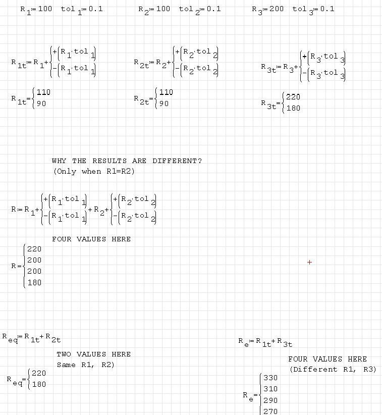

#12 Posted: 2012/7/31 09:17:08
Basile
Basile
8 likes in 172 posts.
Why I am getting different answers?
(http://www.yourfilelink.com/get.php?fid=816752&dv=1)
Tolerance
Thanks,
Basile

#14 Posted: 2012/7/31 10:50:24
Basile
Basile
Here should be...
#15 Posted: 2012/7/31 12:14:00
1,443 likes in 2,935 posts.
Here should be...
it's the optimization in the definition of [MATH]R[/MATH], [MATH]R,eq[/MATH] and [MATH]R,e[/MATH] (see optimization of coloured equations in the attachment)
regards,
w3b5urf3r
sys.sm (13.59 KiB) downloaded 1247 time(s).
#16 Posted: 2012/7/31 12:19:38
Pay attention how sys() is working. In this simple example, every element from both sys() are combined with each other:
[MATH=eng]sys(1,20,2,1)+sys(50,300,2,1)=sys(51,70,301,320,4,1)[/MATH]
Sometimes it behaves differently, it depends on optimization applied.
Optimization numeric:
[MATH=eng]sys(1,20,2,1)+sys(1,20,2,1)=sys(2,21,21,40,4,1)[/MATH]
Optimization symbolic:
[MATH=eng]sys(1,20,2,1)+sys(1,20,2,1)=2*sys(1,20,2,1)[/MATH]
Actually: [MATH=eng]2*sys(1,20,2,1)=sys(2,40,2,1)[/MATH]
To be honest, because sys() in the calculations can sometimes be quite confusing, my advice is to avoid it in calculations. Actually, I did not figure out yet where the sys() environment is the most useful for using - excluding plots.
