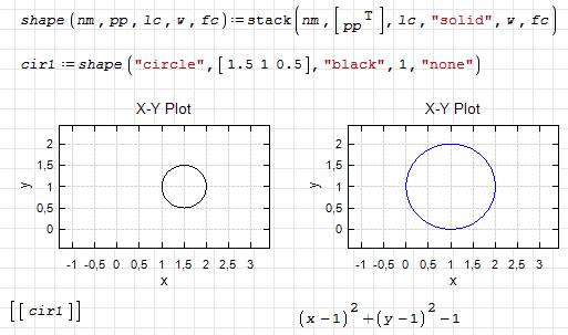

Hi. Without doubts Viacheslav use of him plugin is the better solution. But here some examples about how to setup the plot of a parametric curve using native SMath plots.
circle.sm (30.39 KiB) downloaded 682 time(s).
Also, you can see how to determine a circle given 3 points in the space by Ber7 at https://en.smath.info/forum/yaf_postsm54516_AlgLib-3-1x.aspx#post54516

Construction of a 3d circle on two points and a radius
(Addition of the Razonar example)
RazonarExample.sm (23.2 KiB) downloaded 637 time(s).

From native maths in native Smath.
#6 Posted: 2018/10/13 19:44:46
... code it as a generalized companion utility.
Circle Complex.sm (14.32 KiB) downloaded 658 time(s).
... enjoy the magic circle aperture.
Circle Magic Disk.sm (16.83 KiB) downloaded 709 time(s).
